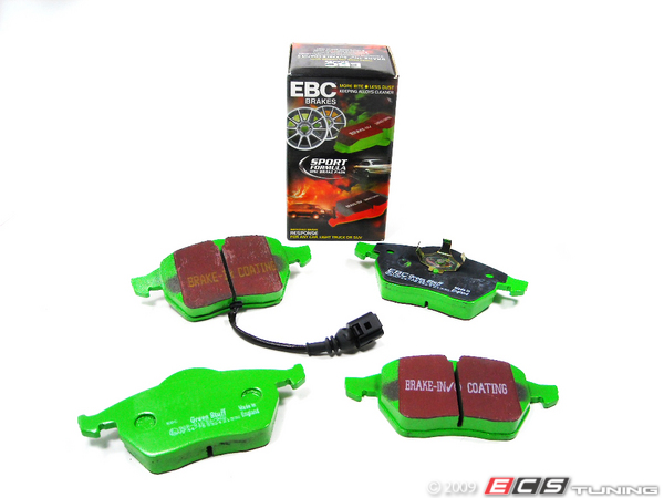

    EBC GreenStuff is a great pad for a price that is hard to beat!
