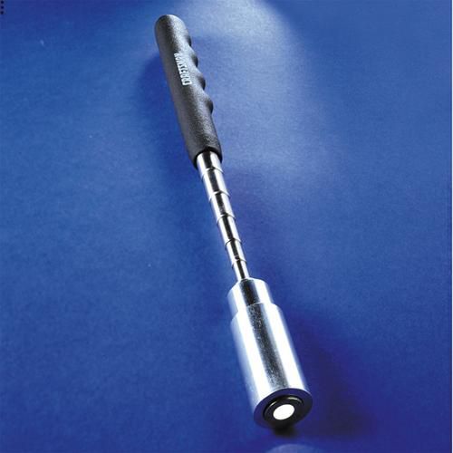

    if someone sends me a intake mani gasket and 4 injector seal kits i will do it again and have my gf record it. ive pulled my intake mani 3 times in the last 4 days.
    if you want to undergo this procedure there is 1 tool that you simply MUST HAVE
    http://community.craftsman.com/Craft...ws?tab=details
    this tool is a must have for picking up stuff you drop, and also for starting that tricky right lower t30 bolt
