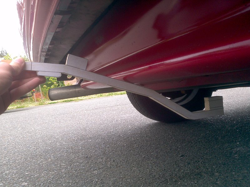

    Looks like I'll be going with the bumper hitch, unless I fab up something custom. I talked to the very helpful Curt Hitches customer support and they sent me a drawing of their hitch so I could check fitment. It looks like it would fit perfectly on a kit-less scirocco but it definitely doesn't fit over the 16v kit.
