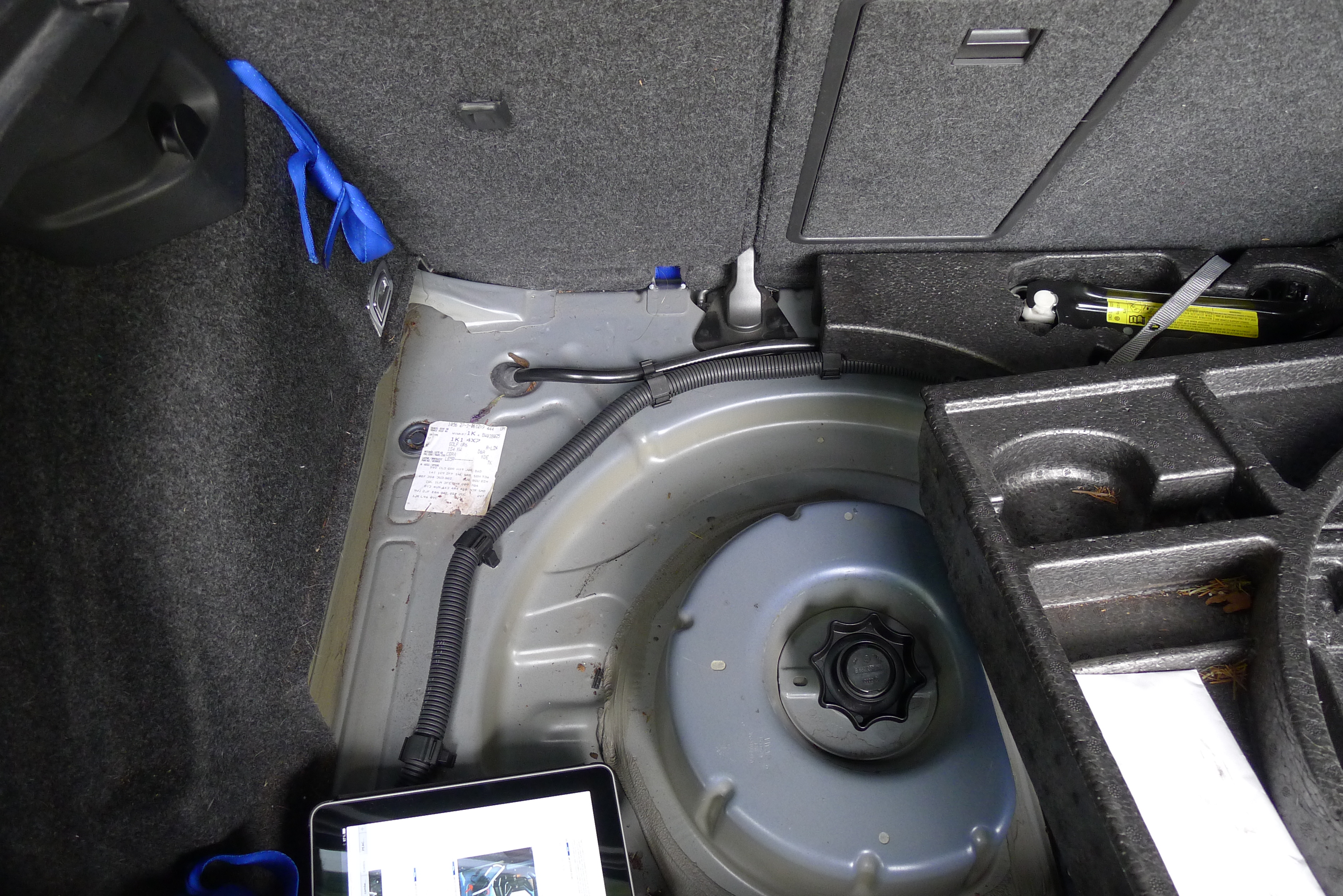

    Kyle -
    I wasn't clear what you were after, but I was in the boot today and thought of you:
    http://www.thepeaches.com/R32/2012_B...s/P1000500.JPG
    http://www.thepeaches.com/R32/2012_B...s/P1000501.JPG

    Thank you for the pictures, I do appreciate them. Helps to see where they go from being inside to outside. Do you have any pictures of the bottom side where the battery terminal starts going to the front of the car?
    -Kyle

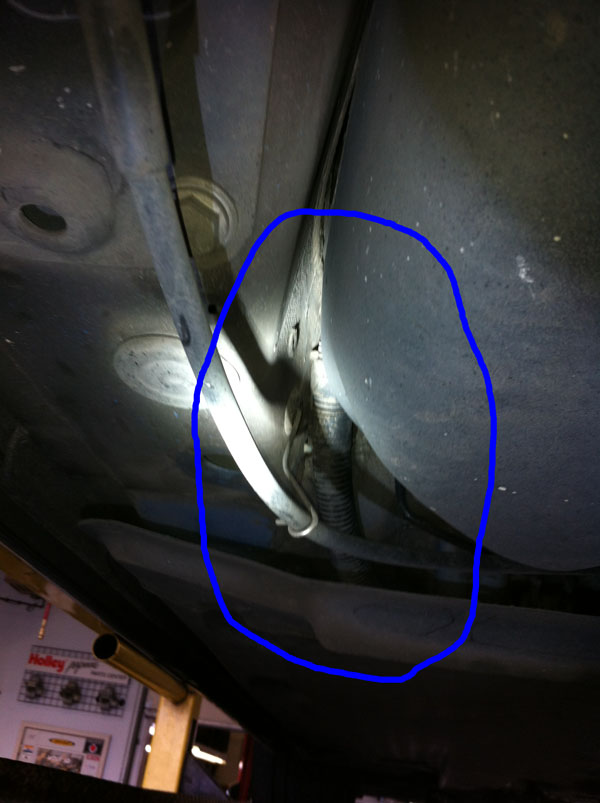

    Still thinking about this, Kyle.
    Had my car up on a lift for about 30 minutes today while we were trying to figure out how to disconnect the Haldex.
    Armed only with an iPhone 4 and a tactical light, I'm attempting to solve your mystery....
    This view is from under the Haldex, looking outboard at the left rear wheel. Inside the blue circle is the battery cable penetration (I think) into the boot area. It's almost directly above that honking big bolt (blue arrow) on the forward edge of the rear subframe or swing arm (don't know my terms).
    Cable stays on the upper outside edge of the fuel tank, and departs forward like this:
    Full rez images here:
    http://www.thepeaches.com/R32/under/

    Soo.. I'm looking at your pictures, and a few questions.. When the cable come down from the trunk area.. Looks like the gas tank is in the floor pan cavity, and the battery cable is right beside the tank, but tucked up in that cavity. Sound about right?
    Then after the fuel tank, it goes under the plastic protector thingy.. any idea where it comes out into the engine bay?
    Thanks for the pictures. They are very helpful!!
    -Kyle

    The words seem to match what I saw.
    I didn't trace the forward end. Do you know where the jumper post is on our cars? Roughly, it's high on the firewall in the engine bay directly in front of the driver. I would think that sort of a "straight line between 2 points" is how the cable routes.

    We have the same jumper post up front, so I know exactly what you are talking about.
    I was curious about where and how many spots VW decided to secure the battery cable to the car. I'm making the assumption that the spots where there is cable securing holes/spots are identical.
