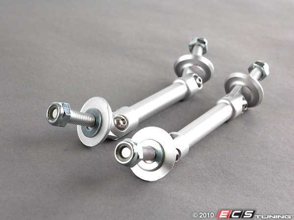

    also, when you see the front of splitters they have 2 steel wires (or something similar) connecting the splitter to the bumper, where can I find something like this?

    The rods stop the splitter folding or bending down towards the road. Personally I think they look terrible but if you need them for functional reasons, that's a different thing.

    The two small things are turnbuckles. They keep the splitter from being pushed down and also allow some adjustment, as to the angle of the splitter.
    Something like this would work. But it all depends on how you want to mount them.
    http://www.mcmaster.com/#aircraft-ca...uckles/=iceyt3

    Lowes or home depot might have them, but they normally just have like screen door ones, but they might. From what I remember as a "kit" they only have ones with eye loops on the ends. You can also just buy the turnbuckle joint at those stores and then use whatever style fastener you would like on either end.
    Aluminum will work. So will carbon and fiberglass. I imagine carbon is what Bazmcc had in mind.

    I had a very similar one made from ABS plastic. Had a bit of flex so it could withstand scraping and bending if it came into contact with the ground.
    Carbon is horrifically expensive and difficult to repair properly if you crack it or split it.

    google "plastic, (your zipcode)" and see if there's a warehouse nearby. or go to usplastic.com or similar sites, they have raw sheet.
    I think you'd want 3/16 or 1/4 thick so it wasn't too flexible (I've seen the pressure on top of a splitter bend them down into the road surface at speed, granted that's on a stupid low car to begine with)
    also i would consider riveting a strip of aluminum sheet along the leading edge for an extra bit of stiffness.
