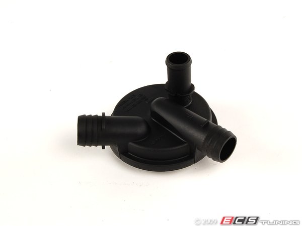

    What's the part number on this thing?
    And does the system works with that thing?
    I found the picture in a movie on youtube..
    Maybe i can find it if a search but my english is not soo good, i'm a norwegian ...

    Don't have a part number for it, but it comes on 2l mk4. It does work, check out my build thread in my sign for pictures of it.

    Hey, i found some good information when i tried to search for it.
    http://forums.subdriven.com/showthre...l+breather+16v
    The part number is 06A 103 465b and it's from Beetle.
    The other one at the picture I don't have part number....

    I could be wrong, but the lower piece looks like the PCV valve from an aba engine. Part # 037129101H.

    I was at my local dealer (VW) and ordered the oil cap breather.
    But the part number was locked/closed from them (couldn't order it) - 06A 103 465b
    Because it was a Skoda part number.
    But he find the right part number by using etka
    06A 103 467E

    Quote Originally Posted by Grenade Gavin View Post
    Hmmm.. I think it look like that breather thing from 1.8T or 1.9Tdi...look close at the pic.
    The one you have find have 3 "pipes"

    Bottom arrow looks like a diverter valve to me, for turbo applications like the engine in the picture. You don't need one (and can't use it anyway) if your engine is naturally aspirated. Not really clear in the picture, so it's hard to tell.
    Edit: just saw in your other thread you're running a turbo, so a diverter is for you.

    The bottom arrow looks like the breather valve off a 1.8T
    Try a 034-129-101-B

    Yes Smiff i've got turbo
    I got ny breather from beetle today but i had to cut it, was 1 cm too high, but no stress, i chopped it and glued it togheter.
    I ordered the diverter today, thanx for the part number
    But will the engine breath good enought with this system ?
    If it works I van remove the catch tank.

    That will depend on your other hardware. Stock 1.8ts with a K03 run without a catch can from the factory, but that's making pretty low boost. What kind of pressure are you putting through your intake? I can't remember seeing any setups with big turbos that didn't have a catch can; in some cases two are used.

    My setup is 1,8 16v KR engine, with KKK K24 7000 turbo.
    1,5 bar boost pressure.
