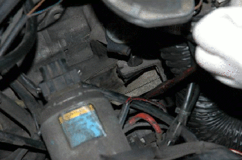

    Normal looks like this..........
    A bit of clarification please, does the clutch not dis-engage or is it never engaged?

    pop off the green cap on the end where the to bearing goes. The arm that pushes on the bearing and rod, may very well be cracked on the splines. It may be hard to notice unless there is a load on it, or pull it out and study it. Happened once, and i learned to chk it everytime now.

    Thanks guys i need all the help i can get. What makes the clutch spring back after being engaged.
    Tolusina-the clutch does not engage pedal hits the floor and doesnt return
