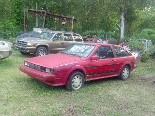

    well here is it before it hit my house
    This car had so much crap everywhere. I know a few animals made nests in the engine bay.
    it had a full ants nest in the weather stripping.
