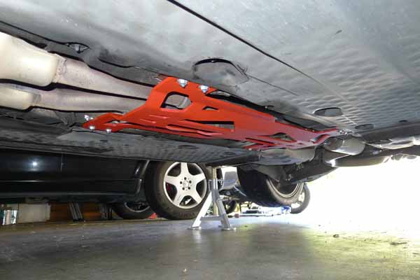

    • Diesel Geek Panzer Plate (skid plate) - been leaving this off more and more, as I'm spending more time at the track, and I need the cooling.

    Well, in spite of screwing up my TyrolSport subframe bushing kit install, I did manage to accomplish something while I had my car up on four jack stands.
    Installed the Unibrace UB. These things don't ship with install instructions. Forewarned with a little "board knowledge", I was not surprised that I was missing the forward cross member. I had purchased a dozen of the nuts from my VW dealer before I started. Technically I only needed to buy four, since four of the required eight were already on the car. Not knowing if the old ones would be reusable, and being *really* prone to dropping small parts and losing them, I bought extra.
    I found this install video helpful:
    The part I wasn't figuring out on my own was that you have to loosen the plastic underbody panels and the UB inserts between the panel and the car's metal floor.
    I also saw a reference somewhere to "pounding some metal flat"; I couldn't find that again when I did the install. There's a heatshield shroud that's a little "poofy" where the forward edge of the UB bolts up. I ended up taking some material off of the heatshield with tin snips. This is probably less than desirable for most of you, but it's what I did... Gave me an excuse to use the huge tin snips my wife gave me from some estate sale.
    I ended up putting a jack under the UB and lifting it slightly so I could get the threads started on the forward set. That did the trick.
    Impressions:
    There is no question in my mind that this thing does something to stiffen the chassis. The first day, I crab walked it slowly over a speed bump, and you can feel that it is more rigid.
    Due to the subframe issue that I'm still sorting out, I'm trying to avoid pulling max G's on the steering rack. Still, I can feel that the car is tighter.
    The other thing that I hadn't thought through: it makes the exhaust sound a little bit different. Much like the way you particularly notice engine sounds when driving next to a Jersey barrier or in the drive thru line, this little slab of metal under the cats reflects some sound energy up into the cockpit. Not night and day, but different.
    I have a used XB to install at a later date. I imagine that will tighten things up even more.

    Thought I'd post a bunch of photos of the Unibrace UB installed:

    How's the ground clearance with that installed?
