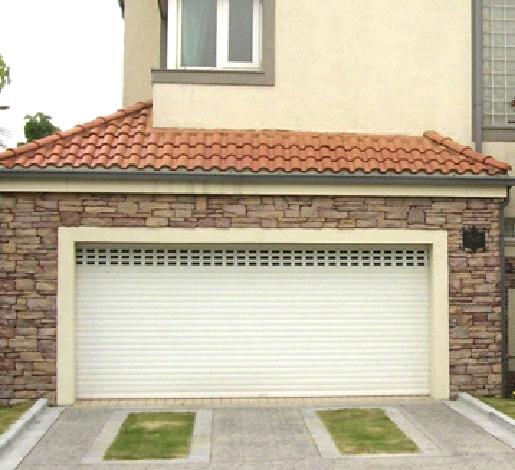

    I'm looking to replace my double garage door with this. I'm tired with garage door sagging, bending in the middle and taking some space in the attic.
    Has anyone done it before?
    This in white would look really good and save some space in the garage attic. I can use the extra space for storage.
    I actually prefer this look than conventional garage door you see in every house and it's more practical.
    Oh yeah, I'll be keeping the house for a very long time so I'm not worry about selling price value because it doesn't have pretty conventional looking garage door.

    Front or rear facing? (The street or backyard?)
    I don't see why not given the benefits you listed, but I'd definitely consider adding some sort of valence or fascia around the box and sides to make it look better and tie into the architecture of the house, especially if it can be seen from the street.

    Quote Originally Posted by windhys View Post
    If I'm not mistaken, this is a photo of the door installed on the inside of the building. If you can install it this way too, then you probably would be OK. It probably wouldn't look too out of place from the outside. And you probably can buy a power opener for it if you wanted one. However, I would bet the door itself is much more costly than a standard garage door and the opener will also probably be quite expensive.
    As for your reasons to go this route, a decent quality residential garage door shouldn't sag. But as you say, they do take up overhead space.

    Why would you have posted a commercial model when your application is residential?
    The residential model I could get used to on the right house. It would look right on an MCM house.
    It's just my opinion, but they look like you're trying to hide something. I've always felt one should draw less attention to valuables, if there's a concern.
    Are you concerned about heat radiation into the garage? It doesn't look like it can be insulated. We have some steel doors at my shop that face south. You can fry eggs on them, if you could figure out how to keep them from slipping off.

    I agree with Barry, depending on what direction the house faces it can really heat up the interior space, and you can't insulate them.

    Some people use roll-ups because a standard door interferes with using a lift. I extended my door tracks to the ceiling, picking up about 24" in door track height. I also used a side-car garage door opener for more clearance.
    I understand the desire for security, but most garage doors are pretty tough to get through. This product looks right in an ocean-front home or an area prone to extremely high winds. It also reminds me of all the pawn, smoke and tattoo storefronts on the less prosperous side of town.

    He said in all his years he's never done a roll up door on a residential garage. They'll only do them on sheds or big detached garage structures. He said the number 1 issue is cost, and the second being that they don't seal up very good against the elements. There is zero insulation on them and the wind will breeze right through it.
    Plus he mentioned that all residential garages doors must have the stop sensors on the bottom to prevent stuff from getting crushed. It might cause issues will a roll up door. It's a housing code thing.

    Another thing is that they are not quiet when going up and down.
    So if you have kids or sensitive neighbors they might not like the racket they produce.
