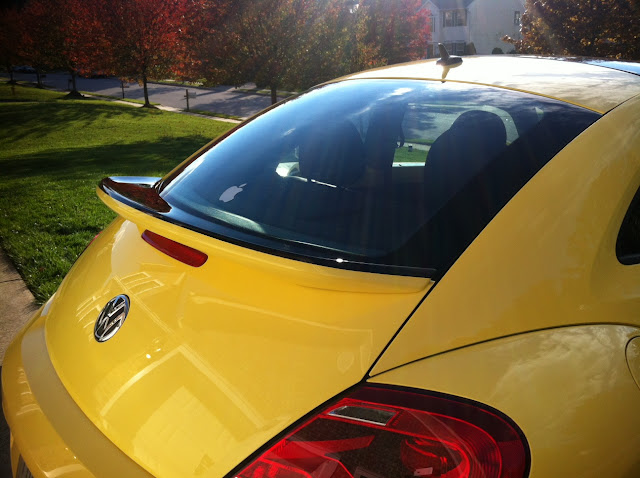

    10-21-2012 09:10 PM #47
    Here are some pics after the install....
    "Just look at those wheels!"

    Quote Originally Posted by the beet View Post
    here are some pics after the install....
    looks great,

    10-22-2012 10:45 AM #51
    Congrats now you look like a turbo a little bit more lol jk. It looks good hope your happy with it bud.

    01-26-2013 04:12 PM #55
    Looks fantastic...it's a one-of-a-kind now!
