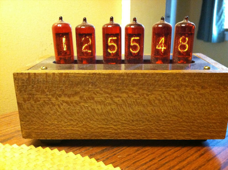

    Here's one my dad made

    That's pretty nice work. Got a pop can or something to place next to it next time? How much are 6 of the clear IN14? Guess I could just do a bing search.

    the in-14's are reasonable, like $25-30 for a set of 6. digits are ~3/4" tall, ~1/2" wide. If I remember, I'll snap a pic tomorrow with something near it

    Awesome clock you made.
