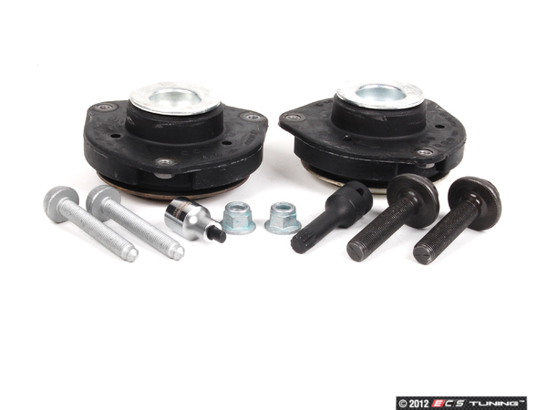

    I am about to replace my shocks/springs and have already purchased new front strut mounts and bearings but am wondering if I should be replacing the rears as well. Car is at 110,000kms.
    Also, what is the difference between part numbers ending in H, R & G?
    These:

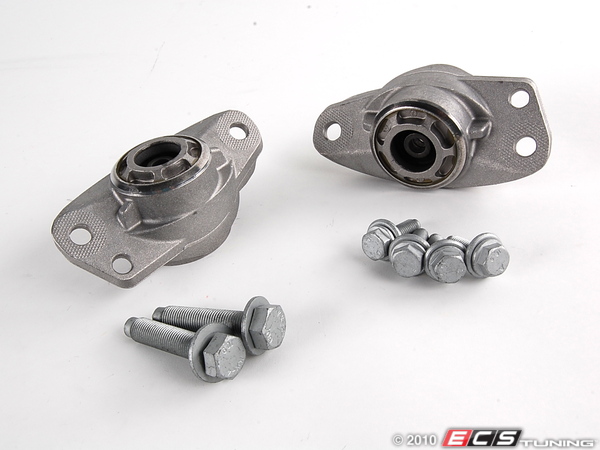

    Agreed on the fronts. I didn't bother with mine because car only had 14k miles on it when they were installed. However, I wish I did as they creak a little from a stand still and over bumps and with proper mounts they wouldn't make any noise.
    ECS sells these and for the $89 they are well worth it in my mind.
    This is a picture of their rear kit
