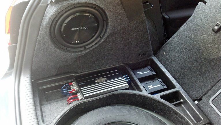

    My wife just got a 2011 2.5L Golf a few months back and i was throwing a stereo into it the other day, and it came out real nice (pictures below) - im a professional at this stuff, but not a pro vw mechanic.

    What box is that? Looks perfect
