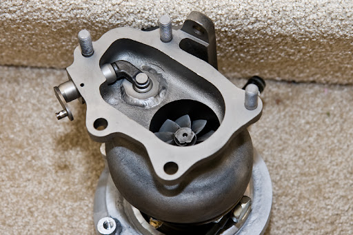

    Seriously...I don't know if there's any way to be sure other than removing the turbo and checking it out. There's just so bloody little room in there to check things properly.

    In the 225 TT, there is enough room (ask me how I know). Eric just need to unclip the rod to the flapper arm, and rotate the gate back and forth to ensure proper movement and feel a positive stop when the gate closes down. Then, with the gate locked fully closed, clip the actuator rod back in and add 1-2 mm of actuator preload.

    You also seem to confuse the wastegate which is an internal part of the turbo and the actuator that is an external device in charge of regulating exhaust bypass. Saying your new wastegate isn't holding boost would mean a faulty gate that isn't operating properly (a turbo issue). The variable in your case is the actuator (external to the turbo and wastegate), if you could take a video of how erratic the pressure generated by the test is, it would help assess if their is an issue or not.
    Yes, wastegate internal and actuator external. Got that. But I'm referring to the leaking (or failure to pressurize). Not sure if its the diaphragm in the actuator or WG flapper door causing the problems.
    If I were you I'd just hook my wastegate up to a bike pump and slowly pressure it to check for when it begins to open.
    i use a compressor. Even with preload on it, it moves with a very low amount of pressure. I had it starting to move at about 4-5psi. but with the same amount of preload Im seeing between 8-10psi. Im really starting to think that my brand new actuator has some problems.

    Turns out my problem is a crappy wastegate. I'm going back to the FORGE. Just not looking forward to doing the R & R again. I bet I can get it done in under an hour now
