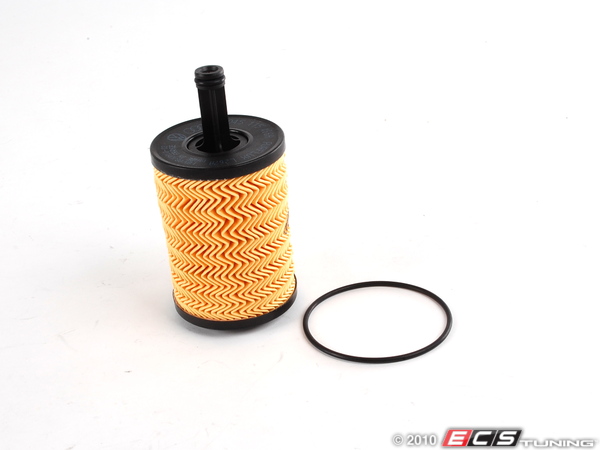

  26. n00b
    Jan 13th, 2011
    Chile
    5
    Skoda Octavia 1.9 TDI
    12-15-2011 09:00 PM #201
    Quote Originally Posted by FLdude View Post
    the one on the filter rod is FOR the drain plug. When i took the factory installed filter out of the car on the first oil change there was NO o-ring on the filter rod. I think they just put it on the filter so it does not fall out of the box as it is small and could easily slip out.
    Belive me I spent quite a bit of time looking up into the filter housing making sure there was no little o-ring stuck up there the first time i did an oil change.
    Just some clever packaging i guess. too bad VW can't tell you ANYTHING like that in the manual..
    All they say is Get your money and go to the Volkswagen dealer!
    Dear,
    I seems to me that you are wrong. The small O-ring is for the filter rod. The drain plug has another kind of seal.
    OldBeaver

    For what it's worth:
    Changing oil on my 08 Passat V-motion. The filter I removed had the small o-ring on the end of it still.
    I called Purolator, because that's the filter I'm using for replacement - a Purolator L38113. They said the small o-ring on the filter should stay in place on the filter, and should not be used on the drain plug. The guy didn't sound like he was 100% sure of that though. Maybe 99%. He said any replacement O-rings should be loose in the box, as the large cap ring is.
    I'm leaving it on the filter this time and not replacing the drain plug o-ring - the combo of VW setting a precedent and Purolator's input is driving that decision. But I plan to look into it a bit more.
    Also, torque specs on the 3.6L are:
    Drain Plug: 30Nm
    Filter Cap: 25Nm
    Filter Cap Drain Plug: 10Nm
    Edit 9/23/12: I think that the small O-ring should STAY ON FILTER, and not be removed to use on drain plug. I think that this O-ring is intended to seal at the to top of the housing, and that removing it risks oil bypassing the filter. However, if you wanted to pull the slightly used O-Ring off of the used filter each change, and put that one on the drain plug, that may be a good idea.
