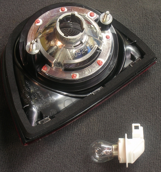

Re: 50W Reverse Bulb (mujjuman) » | « » 4:01 AM 3-5-2008 | |
| Quote, originally posted by mujjuman » | why? i understand if your tails are tinted... but are you trying to blind the person behind you? or do you just want brighter bulbs because it looks cool.... the latter i understand |
I do not care about the "look". I care about what I can see behind me at night. I will be adding wiring, euroswitch and changing to Valeo EU Golf LED tails when the weather breaks. In the process I will change from two backup lights to one backup light and one rear fog light, like the OP. In my case, I back up a 60' drive to back into a tight garage space, often at night. The potential 50% loss in backup illumination with the new tails is of concern. Optimizing the remaining backup light would seem to be a wise investment. The halogen lamps appear to be the best bet. -- since I am switching to EU LED tails, thought I should check to see if the backup lamp is the same. Even though the outer section is LED, the new matching inner section (rear fog | backup light) are still filament lamps. I don't think the LED tails use the same backup lamp as US OE? | Quote, originally posted by Markings on base of supplied backup lamp in Valeo LED tails from TM Tuning » | GE 1057L F 12V P21W {E1} 2DX Hungary 25AUG07 NIBTW the fog lamp in this set is exactly the same part |
Valeo LED tails from TM Tuning - inner right - backup light (protective film still in place)
 to remove the lamp holder from the fixture, twist 1/8 turn counterclockwise, pull out. The lamp holder is keyed, one notch is wider than the other three, so it only goes back in one way
Valeo LED tails from TM Tuning - inner left - fog light (protective film still in place)
Modified by JetTurbo at 4:30 AM 3-5-2008

50w installed with pics http://forums.vwvortex.com/zerothread?id=4513622
