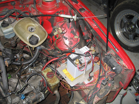

EDIT: See page 8 for the most recent updates on the project, below is the original intent of this thread, an engine bay cleaning: Here's what I've got to work with:
 (I've converted to the factory non-AC setup and single fan since this pic was taken)
Here's my ideas to make the bay a bit nicer: change fuel dist (I have a fairly new one lying around), but what do i do about the injector lines? Where can I find non-rusty ones? Classifieds my only option? As an extension to this question, I want new or rebuilt injectors. Where can i locate these? clean/paint rusty parts (fan shroud, brackets, etc), but what kind of paint would last here? What kind of prep work is involved to keep rust at bay? manifold- shine up "DOHC 16v" (probably not full polish, but clean up the corrosion). I'd like to paint, but that mean the valve cover too, and that's just a lot of work  Also, I was thinking about making a new engine harness. Mine is a little hacked up here and there anyway. Solder and heatshrink of course, but where would I route it? All the harnesses, the ECU, engine accessory, and front end harnesses, would need some cleaning up. I was thinking about relocating the ECU elsewhere and getting rid of the rain tray covers too. I'm also getting the car painted soon, but not the bay (for cost reasons). How would I go about prepping and rattle-canning the bay myself? This is a daily driver so deleting the reservoirs is not an option either. Any other suggestions are welcome! Pics of mildly clean bays are also welcome! Thanks guys. Modified by VDub2625 at 1:55 AM 5-27-2008

split looming and zip-tieing like/close wires is always helpful... new battery cables and battery terminals always help as well. i made my own battery cables out of thick car stero wire and bolt it yourself autozone terminals... i replaced both ground and live wires and it helped make that area of the bay look much better... it may take a while to clean a bay up, but doing things like painting, polishing, and cleaning parts can make a huge difference... its really worth it though once you pop the hood and people look at how clean your bay is. best advide anyone will give you is to look at other peoples 16v bays and pick and choose what you like and dont like... take some of those ideas and utilize them in your own bay. there are a lot of very clean, and tasteful 16v bay out there that you can model yours after. might be tough to see them...

There are plenty of wires that can be re-routed in an OEM fashion. Some can be shortened, some will have to be lengthened. If it works for you, consider removing the washer bottle. I realized I don't use mine, so I 86'd it. Remove parts for cleaning and paint. Like your ignition coil and TB cable bracket. Remove your rain tray and clean it. Under it. Clean the metal tray and reshoot it too. A brass brush is great for cleaning light crud off metal. Get fresh clamps too. In fact, look for anything zip-tied or just hanging and figure out where the OEM path/clamp/tie-down goes and replace it. Take the sticker off your battery. Remove, clean, and paint your rad shroud. Your rad mount hardware could be replaced too. A fresh hood latch up/down is nice cheap add-on too. You can pull aside many items in the bay and lay down a fresh rattlecan finish. It just takes time and patience to clear a spot, let it dry, and then go back over stuff w/Goof-Off because of overspray. Here's what a steamer, degreaser, paint, brass brush, patience, and lots of cotton swabs w/Goof-Off can lead you

Thanks! That is really helpful. I'm looking for the OEM+ look. Your bay looks amazing!Trust me, when I got the car, the bay was AWFUL. Both frame rails were covered in black grime and wax protectant. I already had to paint under the battery because of rust issues, and that battery is getting replaced because it's about a half size too big. I was going to buy an Odyssey PC680 motorcycle battery from a friend to save weight and space (but it'll stay in the bay). Forgot to mention that my tranny used to be spraypainted black, and about 45% of it still is is there a way I can try and get the rest of the paint off without removing it? thanks! here's how I got the car:

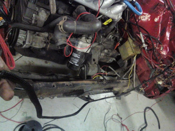

I started some stuff today:
 It's not much but I did get rid of lots of extra wire from the crappy fog light installation and other things. I also need to grab a bunch of spare brackets and an engine harness from the junkyard to get that stuff started. What color should i do the metal brackets and stuff? i was thinking black but that never looks good. And what about little things like the parts of the throttle? I can't just paint it, but those little spots of rust will never look good. Is my only option finding a junkyard one in good shape? I am planning on how to re-do my harness, but it's going to be difficult without the car to work on, so I'll have to set aside a week or so to get that all done (and paint at the same time). I'll probably move the ECU to inside the car (where, exactly, I don't know), to clean up the mess of wires that run from the fuse box, into the bay, up to the rain tray, and back out again. I was thinking behind the center console, but i don't have a lot of room there. Maybe above the fuse box. How did you secure that battery in the rain tray anyway?

Here's where I sit now:
 The bay itself still has to be washed, but it took me all day just to get the wax out of the rain tray.... oh and also took out all the harnesses figure I'll run the ECU harness through the rain tray (left side of the engine through a plug on the left, right side on the right), and try and get the ECU up above the fuse box. If someone could help me figure out how to mount it up there... also how do i get the wires from the ECU into the rain tray without going through the engine bay
 Here's what else I got done today:
 Here's what my harnesses look like now
Modified by VDub2625 at 6:22 PM 6-2-2008

| Quote, originally posted by VDub2625 » | Here's what my harnesses look like now
aaaaaaand you're ****ed....

Naw this is the fun part  I ended up getting a little distracted with the fuel distributor so all new injector seals, cups, fuel filter, etc are coming tomorrow just in case. I love GAP

The more I think about it, the more I don't think I'm going to go crazy hiding the ECU wires. There's just some wires that can't be put away. I'll still try and run the cross-bay stuff though the rain tray, but the ECU will probably stay in the rain tray instead of going inside the dashboard. I'll cut off the factory covers and re-coat them too, and repair or extend any wires that need it. I'll use this excuse to upgrade to a 4 wire oxygen sensor too anybody know vehicles that are cheap sources for a 4 wire? Kinda like we get the cheap 3 wire from an '89 stang.
