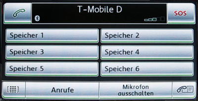

Another toy arrived today... The Fiscon Mobile Pro Bluetooth kit...
You ask yourself... how does this relate to a BT build... well I will show you... This system integrates quite well with the RNS 510 (the OEM navi unit...)
and with the OEM MFD
allowing you to send SMS, dial phone numbers, streaming audio from the device etc etc... AND it adds a few extra practical engine-related displays to the MFD which is how its related to the build!!!!...
Amazing all that info will show up in the MFD... (the gauges are now officially just bling... aside from the EGT gauge...) I wasn't expecting the arrival of this... but I am pretty stoked about it!! :rockin: One more new addition... Tomorrow the BSH True Seal Intake is arriving! Also the 2.5" to 3" adapter so that it will accurately fit the Turbo inlet as well... (will also give a little more clearance for the WasteGate...)  How it will look (minus the OEM noise pipe...)
Many thanks to Phil@BSH on this one... talked to him over the phone and was able to get the intake out right away!  Also big to Lou for his great review... inspired me to pull the trigger!  P.S. my Neuspeed P-FLO is up for sale... Make me an offer
