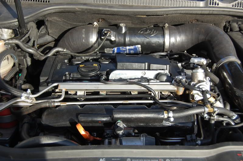

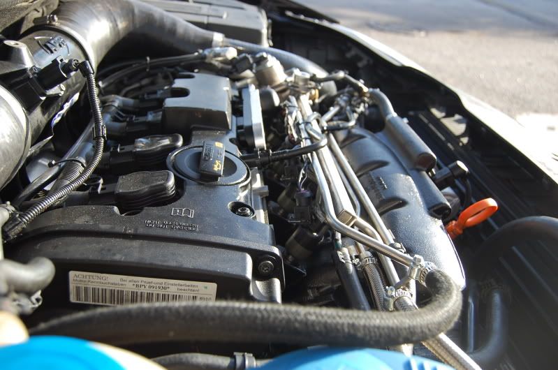

      Recently we have had great success running E85 in our shop cars including our 700whp 10 second Porsche 996TT and our 750+whp 8 second Evo8. So, we decided to convert the first FSI to run on E85 ethanol. The advantages of running ethanol over traditional fuel are extensive and include a cleaner and cooler burn in the combustion chamber which translates to the ability to run high compression, high boost, and lots of ignition timing... a recipe for lots of horsepower. Not to mention $1.69 a gallon, that harnesses more power then race fuels available for $25+ a gallon. Preliminary tuning is being carried out as we speak (Thanks [email protected]), and dyno numbers will be available within the next week. New modifications performed to support ethanol include: a cast aluminum intake manifold incorporating (4) 1000cc fuel injectors, injectors are controlled via a 034 motorsports ecu (thanks [email protected]), (2) Bosch Motorsports fuel pumps, and a custom fuel surge tank which incorporates the pumps mounting brackets.

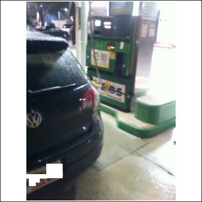

      Filling up at the E85 Pump

      I think he is doing dual port injection. It appears from the pictures that the upper fuel rail is purely pressurized by the LPFP whereas the FSI injectors are still driven by the HPFP.

      you are correct, we are still using the fsi injectors driven off the hpfp and the port injectors are driven from the low pressure fuel system. The manifold did come with aluminum flaps in it, but we took them out.
