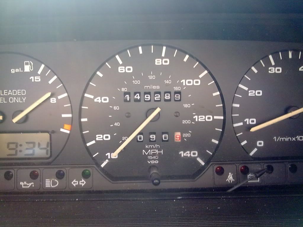

      You should swap in an early Euro-Van Intrument cluster.
      It has a speedo cable, 4-5k redline Tach and MFA. Its looks like a corrado/passat style cluster. I don't have any pics but I take one next time I go to my storage unit.

      Seen it. Want it. Dont want to deal with KM/H in cali anymore - Do want to know why my tach doesnt work though. Pulling signal from the 2nd wire from the alternator (2prong plug style- one is blue for exciter, other is red/black for what i THOUGHT was signal)

      This guy has the Passat AZZ instrument cluster forsale $50
      http://www.vwdiesel.net/forum/...995.0

      Sweet jesus- PM'ed the guy about the instrument cluster! That would be PERFECT! Tired of not knowing what RPM my motor is spinning at in 5th - may need to opt for a shorter gear in the future. Currently using an ATA G60 tranny with a .75 5th. I think I need to get something a little bit shorter...... no money though right now
