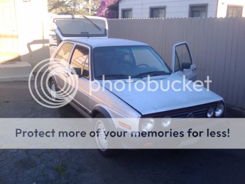

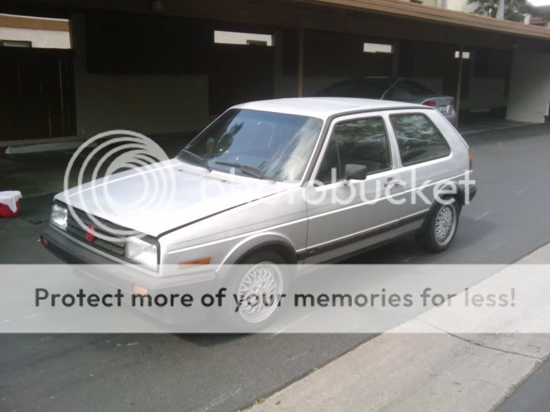

      my name is Marcel and since the mk2 forum seems to be back to normal, i think its time to make a little thread about my GTI. It started in March 2010 after i moved to SoCal from Germany in February. I was actually looking for a MK3 Jetta but found myself buying this allmost original 87 GTI 16V with 230k miles. Only mod was the 90 GTI interior.
      The first mods there tune up and several parts since the 16V ran like crap.
      replacing a cracked exhaust manifold

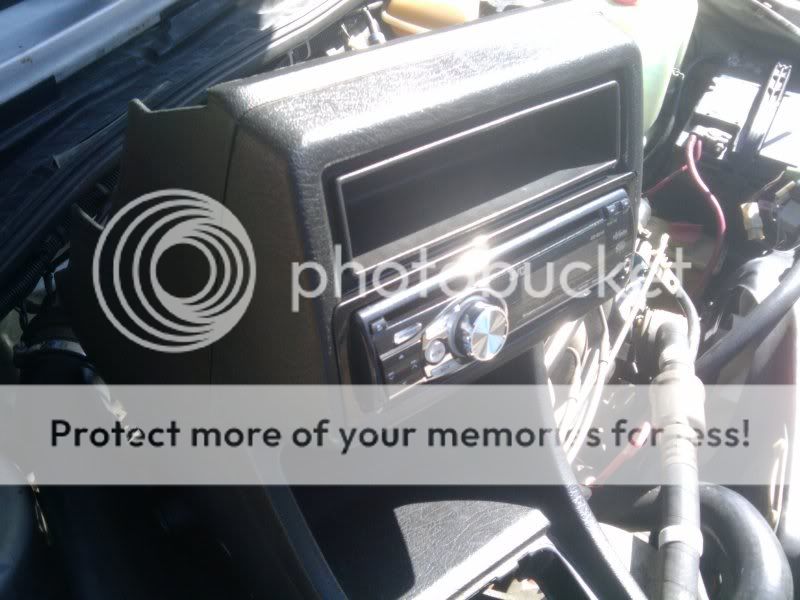

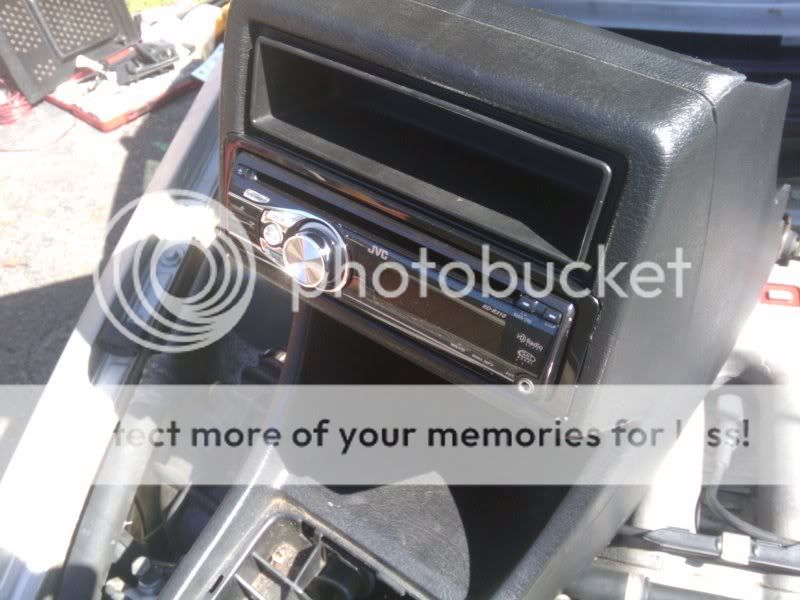

      after a time i changed the front end to quad light GTI and modified the center console to fit the radio

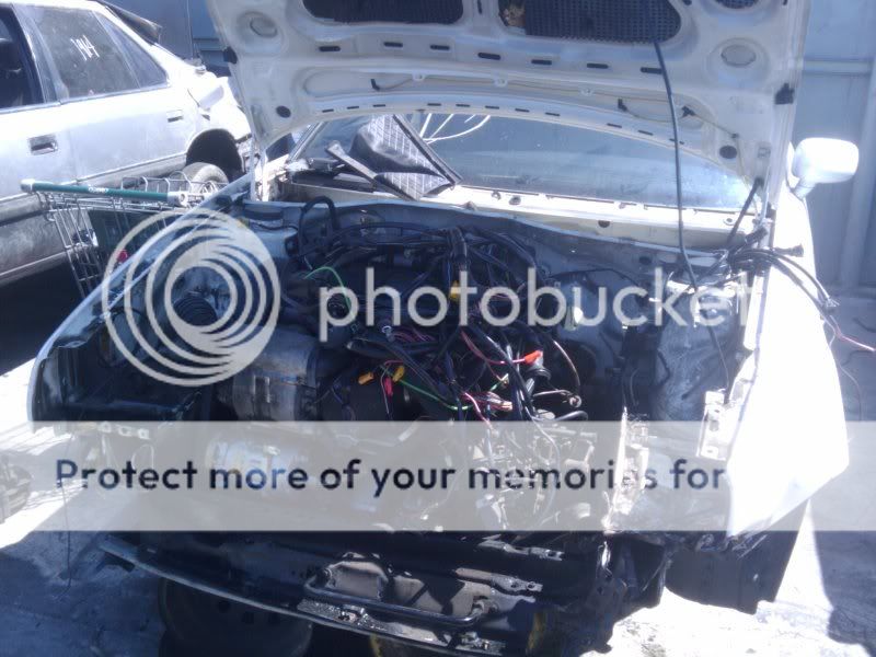

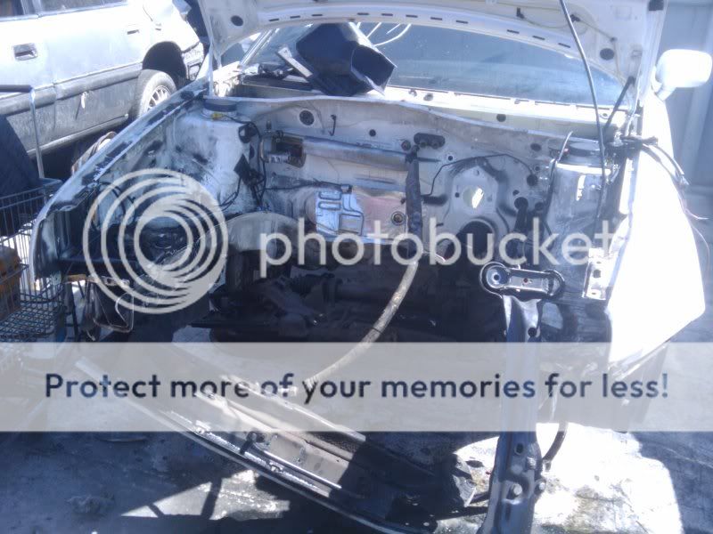

      After dumping more and more money in the 16V, i found this little gem in a small junkyard, a unmolested 90 Corrado G60 with 28k miles from new
      i had to have it, but no tools to do the job, i had to come back the next day and bought almost everything necassary for the swap for $600
      the shell we left

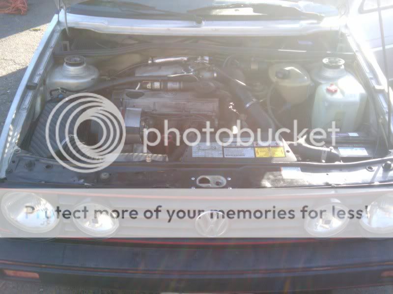

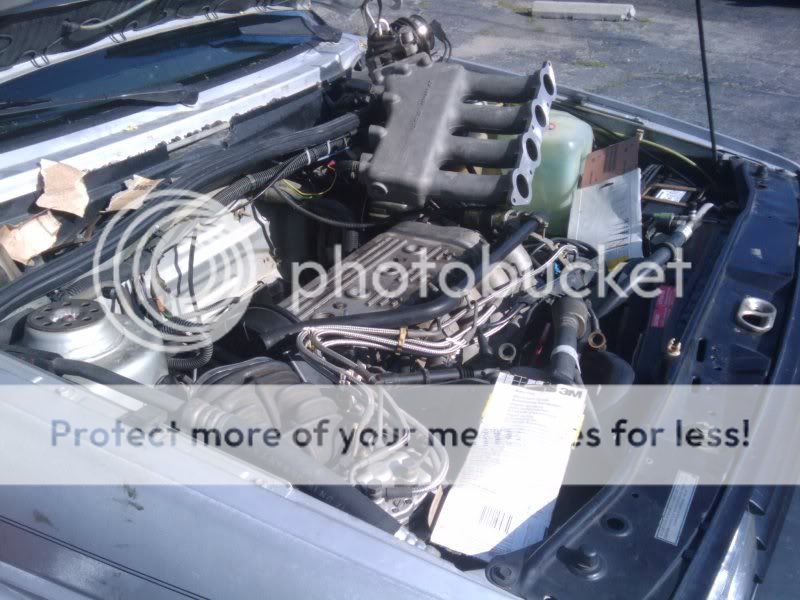

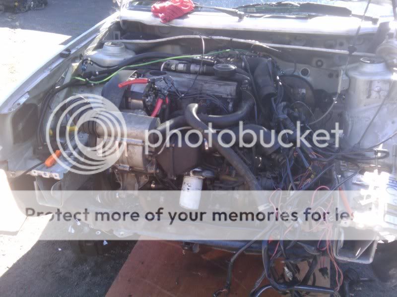

      then the time came for the swap and it wouldn't happend with out the BIG help from my friend EricD, he is like a walking Bentley Manual, the things we did before putting the engine in the car were new timing belt with water pump, deleting the AC and PS, new belt for the charger and the drive belt and a mocal sandwich plate for running an external Volvo oil-cooler.
      Start of the swap
      16V coming out
      so much space
      G60 in
      while doing the swap, i renewed all the suspension parts, control arms, bushings, tie rods.
      Since the fuel pump died the same day we couldn't get the engine started that day and had to finish the swap the next day.

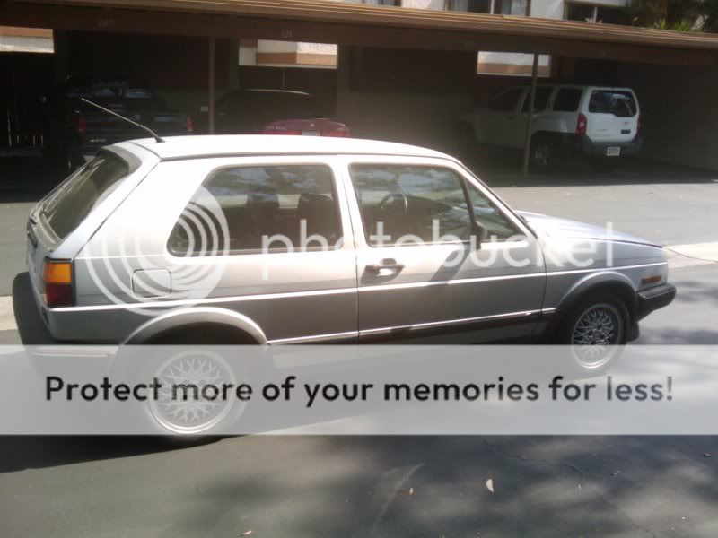

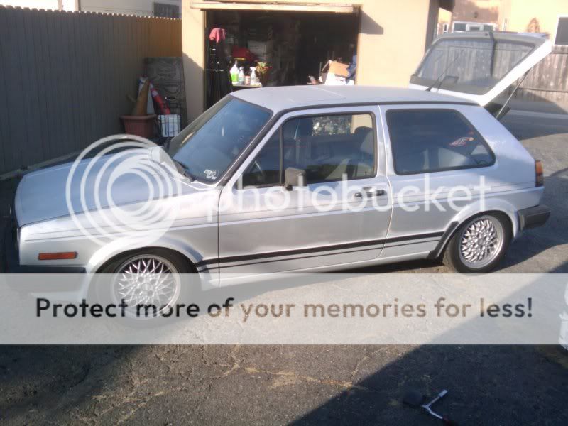

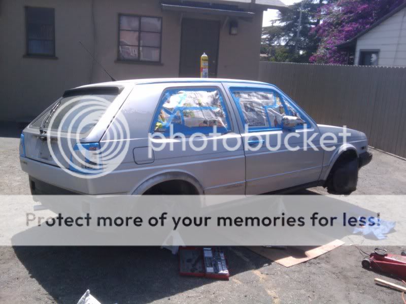

      After a while i got bored and wanted to change the look a little bit, so i pulled the flares and moldings off and painted a MK1 GTI stripe on it while taking care of some rust on the rear window frame
      Changed the hatch glass to one without the third brakelight and with "Car off the year 85" and change the badges on the rear

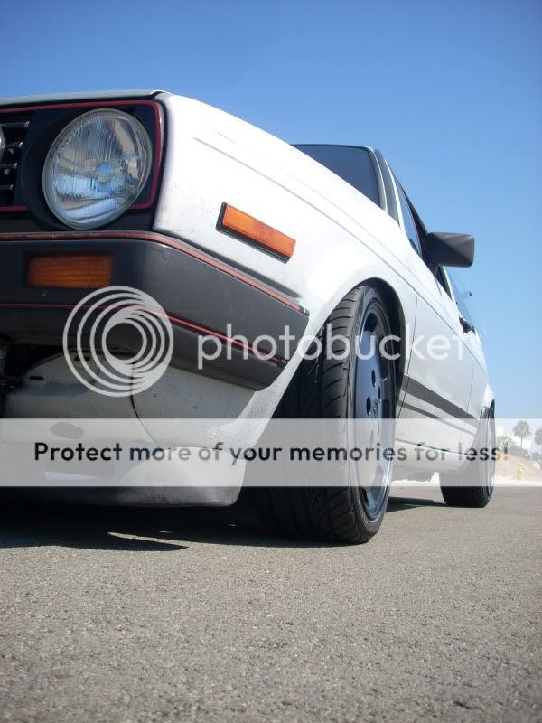

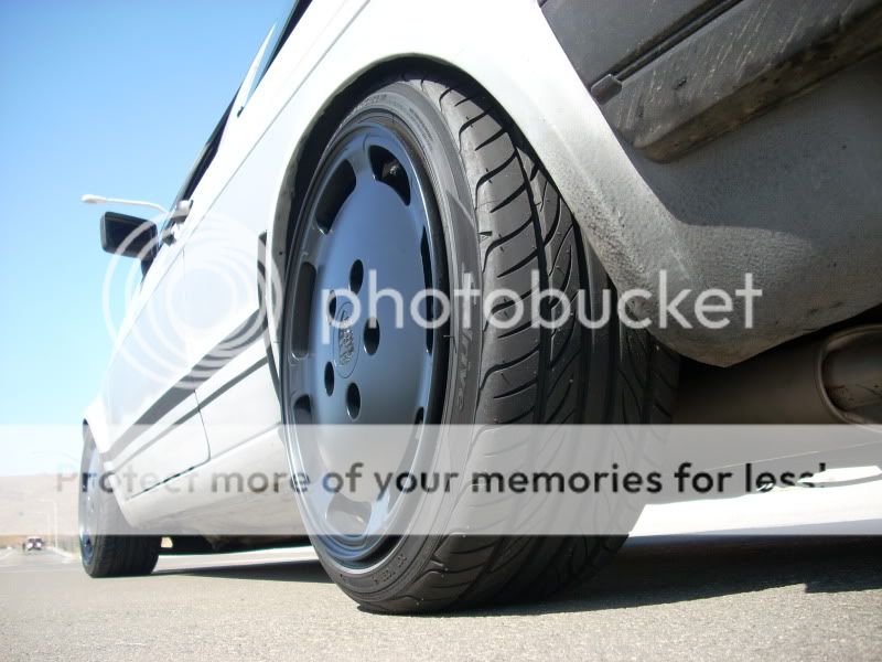

      Got me some Porsche 7-slots and got them refinished in satin black. Specs off the wheels are 16x7 ET52.3 front and 16x8 ET52.3 rear with 25mm adapters all around and added some pop-out windows.

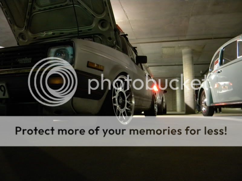

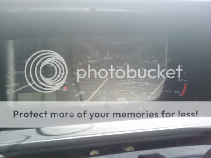

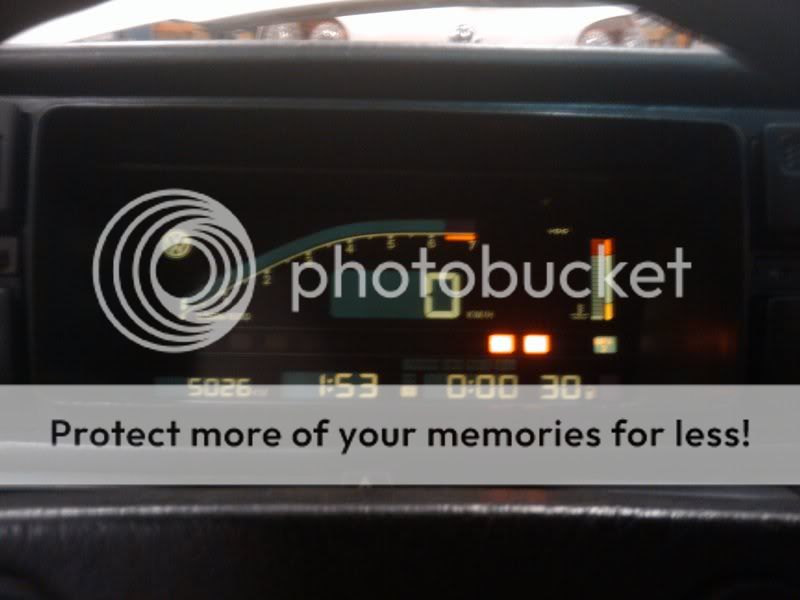

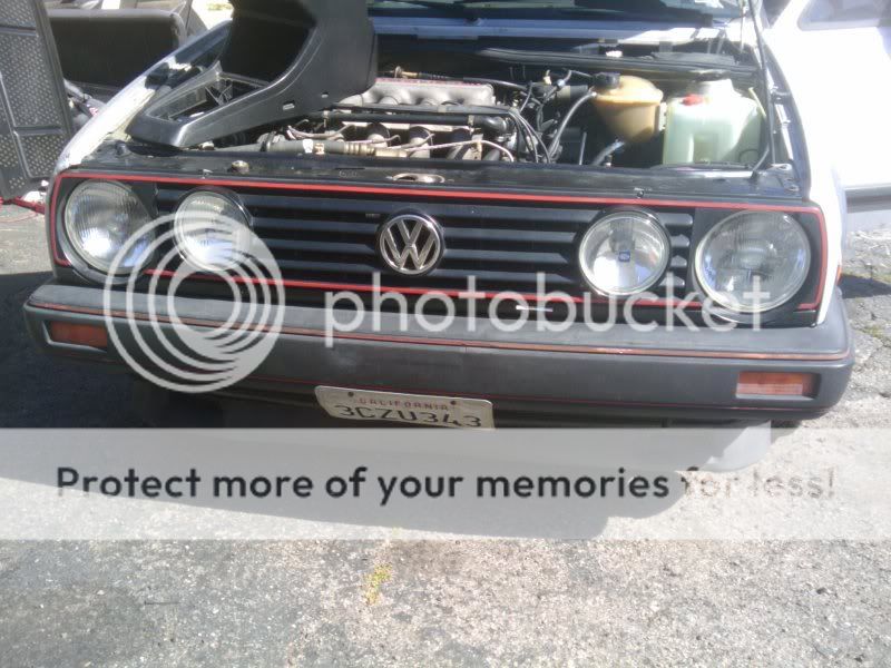

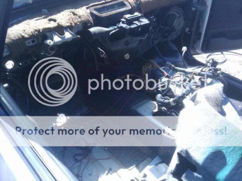

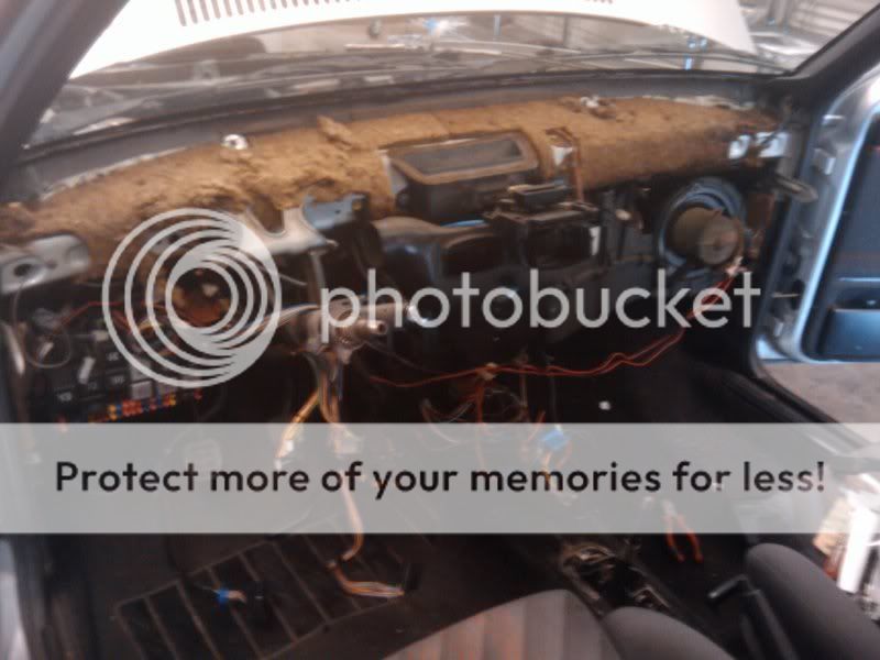

      In the mean time i swapped the dash to a non-AC one which i got from Germany with the non-AC airbox and fitted a digifiz cluster and changed the front end to westy for some RnD for the 4door.
      old dash out
      new in with digifiz
      and westy front end with Hella DE lights from Amir

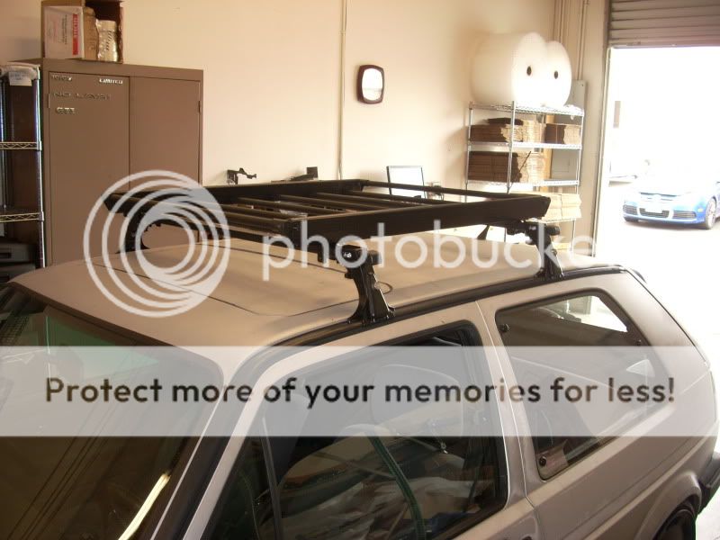

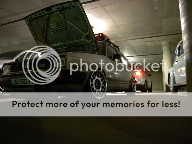

      the latest update were a votex center console i found in the junkyard, a roof rack with votex luggage rack for the extensive junkyard tours and some 16x8 snowflakes from 1552, awesome guys otherthere

      did u have a complete digifiz harness or did you have to splice yours if you spliced yours can you send me some pics of the colour wires you spliced in to
      i got the digifz with the CE2 adapter harness, i only had to make a connector for the speedsensor and some of the warning lights on the fiz.
      If you need some wiring schematics i can send an email, if you IM me your email, or i am going to pull the cluster tommorow for some work and i can make you a schematic from the fiz to the CE2

      Car looks nice. Are your fenders rolled to accept the snow flakes? What's the ET on those?

      i rolled the upper 1/3 of the fenders and the ET is 30 fits nice with out big rubbing issues

      Dig it. Please tell me you didn't actually tape off your door handles to paint...

      guilty as charged i don't know i was really to lazy to take out 2 screws
